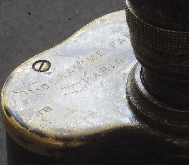

MessageSujet: guide-bar ocular   Ven 26 Juil 2013 - 13:31
Left ; LONROP x6, Deraise Fab. Paris, M.G. 52-36625.
Right; Goerz D.f. 99. Production number 61062. P. No. 6688.
Both seem to carry guide-bar [Geradfuehrung] ocular. --- When turning the knurled ring, the eyepiece don't turn but move up or down. With other binoculare the Eyepiece and ring is in one and both turn and screw up or down.
Sorry I must use english, but please remember that my prime language is danish.
Anyway I find it most interesting that this okular system have been used only in very high quality bino's, Using the bino's it work much smoother and with so old pieces it must be a relaible system.  Of the 8 individual okular systems in the D.f. 99 we posess all work perfet , and I am sure they been used flawless. Also a complete different okular, than what is practic with most other bino's, -- cost more.  But here is my question ; do anyone know of other binoculars where this okular system was used ?
This binocular carry guide-bar [Geradfuehrung] oculars, something rare and interesting, as with bino's everything has a reson.

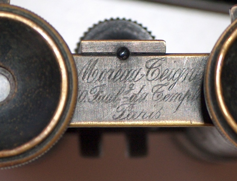

Elle est bien marquée de la Maison Moreau-Teigne :

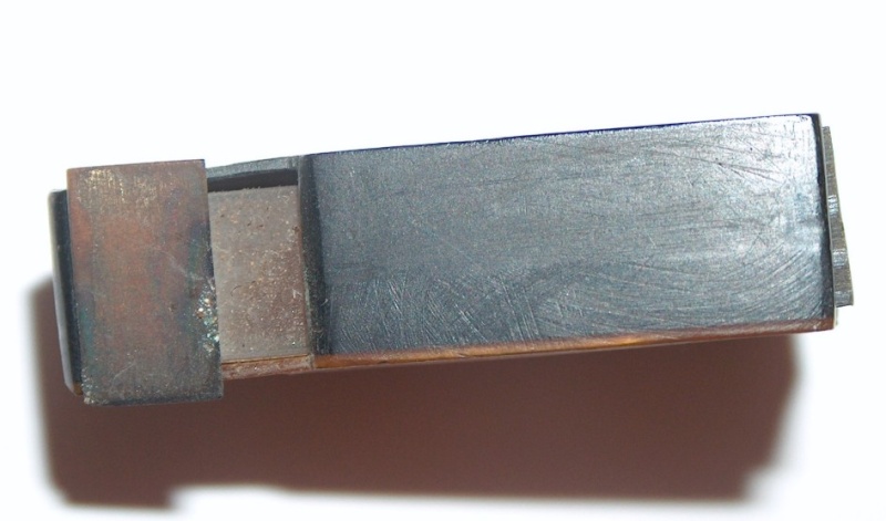

Pour poursuivre un peu, quelques photographies du prisme télémètre Souchier qui accompagne la jumelle-télémètre du même inventeur pour constituer l'équipement règlementaire adopté en 1894 :
et son mode d'emploi (j'essaierai de scanner moi même un de mes manuels et j'en substituerai le résultat au document que je poste) :
